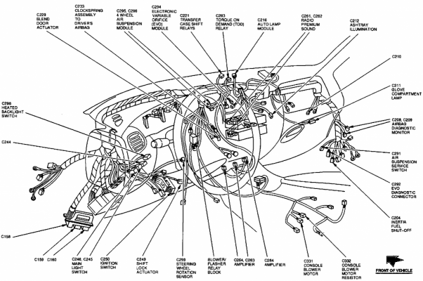

My '97 Expy Eddie Bauer 4X4 does not shift into 4H or 4L. The dash light indicates AWD is working when switched on. The switch checks out so I'm thinking it may be the relay. I do not hear any clicking in the dash (where I believe the switching relay is located) at any switch location including AWD. I want to test this relay next but getting mixed messages with a google search on where it is located. Some say it's under the oval inset on top of the dash (can't find it there) while others say its beneath the speedometer bezel (I haven't attempted to look there yet). Any definitive answers on this and instructions on how to get to it? Thanks for any assistance I can get. I've owned this Expy since new and would love to keep her going.

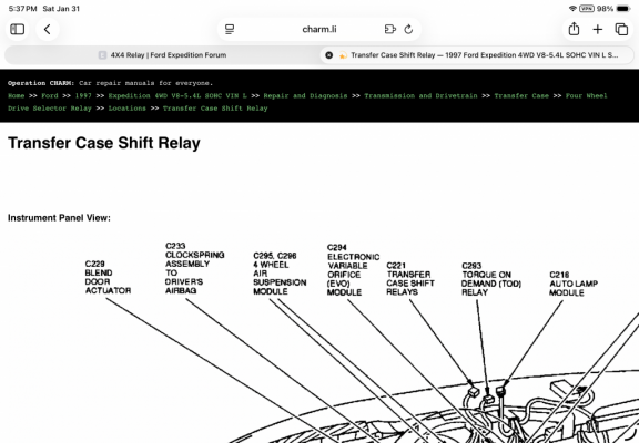

It says they are under that removable cover on top of the dash. Charm.li is a great website it uses factory manuals for diagnostics and drawings.
