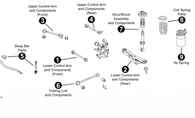

Thanks for the feedback. Yes I was oversimplifying the rear setup. Not a tie ride, but the upper control arm/ toe link for the rear suspension. Item 4 in the diagram below. I also agree with you guys and took it to a local Ford dealer for inspection. They confirmed Rear upper control arms and Front tie rods are loose, nothing else. So to docraymunds point. Just do the practical thing. I agree on the comments made on Moog components. I had a similar experience and tried to save $50 on a front end rebuild and it ended up costing me double by having to do it agaain 50k miles later.
