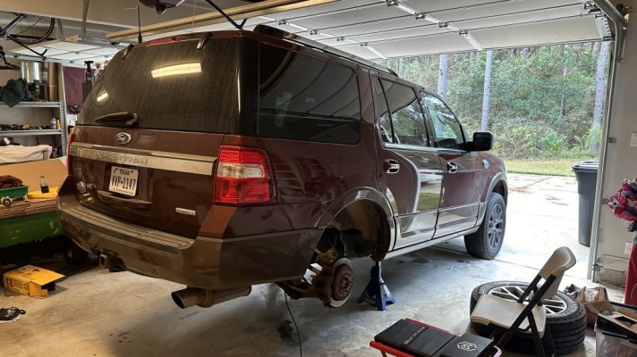

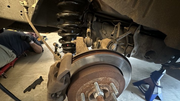

Yesterday I replaced the rear struts and I am planning to replace the front struts in the next week or so. I’m using KYB all around. I bought the AutoZone premium outer tie rods as well. I saw somewhere that if you’re replacing struts and tie rods, that you should probably also replace the sway bar end links. Maybe also the front sway bar bushings?
What do y’all think?
