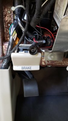

Anybody know where the remote start programming button & LED light is on a 2012 Navigator? I have looked under the dash on both sides and can not locate it.

I've seen them anywhere from under the steering column to up behind the pedal adjustment button. On my '11 Expedition Limited it's the latter. It's reachable from under the dash, but it was much easier to access by simply removing that side panel.

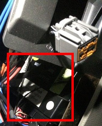

That is the brain to the OEM remote start, also if your truck didn't come with remote start, you won't have the pats button, the pats button is located on the OEM remote start harness... Hope this info helps

Finally got around to programming the second remote fob and changing the door open shut off feature. button was right above the pedal adjustment button. I took off the lower dash trim to access it easier.
So much easier with that panel off. I did it the first time with the panel on and I felt like I was trying to input an NES power-up code (up, up, down left, hold B, tap select ....).

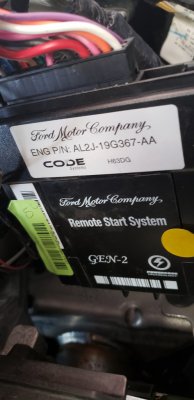

Ok so went out and tried this again with both the 100/200 programs neither worked had hope that the 200 was going to work because it uses the panic button to instead of the break pedal but no luck. Here is a picture of the "brain"

Check and clean the terminals on your horn....see if that helps...

Maybe try resetting... The remote start computer.. Disconnect the module and then disconnect the battery terminal, turn the ignition to on position to drain the rest on the system then connect battery, then the module... If the keyfob doesnt work just follow the instructions on programming a key fob...

My part number isn't in either of those manuals is there a different system? Or do you now how I could lookup a manual with this part number?
Thank you for you help!
