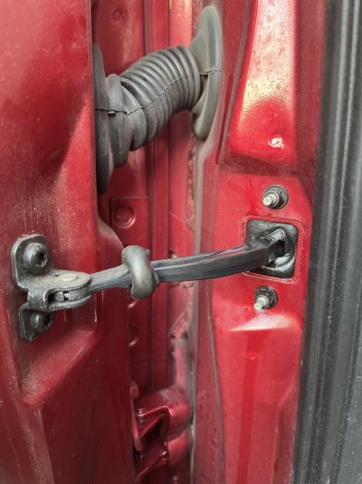

This thing sounds bad, anyone know what it is or have replaced it??

I found the answer on YouTube after posting here, the part that attached to the door is broke, easy fix look like. Get a small bolt and cut 1/2” long piece and place it behind hinge. It keeps the broke piece tight
