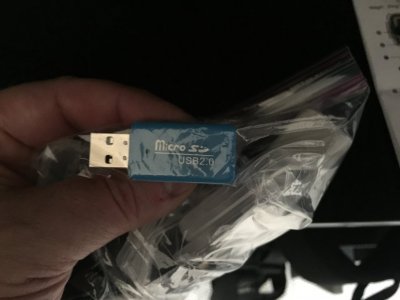

Actually, FWIW, I was using a USB 2.0 adapter in which you slip a micro SD card, as shown in the photo. I used the same adapter when I first tried the 128GB card and then the 32GB card, so it appears the issue was with using a 128GB card. IMG_0081.JPG
