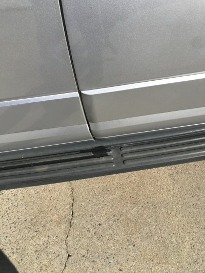

Here is pic of rear pass door.
Is there a drain somewhere at bottom of door? I have looked and can find none.
Keeps leaking. All snow has been off car for several days now.

There is a plastic piece on the bottom of the door that is the drain. They often clog. They pull right out. Most people pull them out and leave them out because they inevitably clog again, and you obviously don't want water sitting inside the bottom of your door.

The drains are at the bottom of the door near the weatherstrip, and have black plastic inserts that are mentioned in post #2. The same inserts are used on the inside lip / seam of the rear hatch door.
Pull the black plastic inserts out, then use the non-clasp end of a sturdy zip tie to clear any debris.
