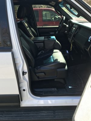

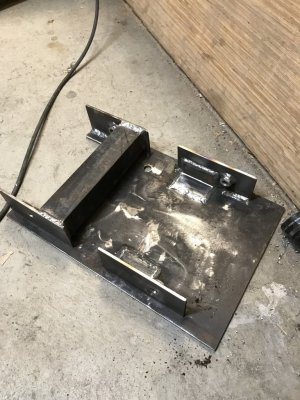

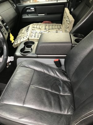

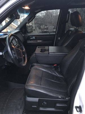

Matching leather jump seat out of a 2012 f150 that features the head rest and shoulder belt. All seat belt components are incorporated into the seat. I used a piece of 3/8” steel plate with 3/16” steel reinforced with angle iron in a few places and bolted to the seat using 4- 1/2” bolts and lock washers. The plate is notched in the front to fit the hump in the expeditions floor board and bolted through the factory reinforced mount holes with 1/2” bolts and 2 more 1/2” bolts in the front of the mount through the floor and reinforced underneath.

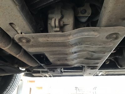

Yeah no problem at all, I was impressed with how many skid plates are under this thing! I will try and post some pictures this evening

You would also need to make sure that the mounting bolts are strong enough & you can mount a seat belt. Hate to see your passenger on the news for flying out the windshield seat and all.
Seat belt is integrated. Mounting bolts could tether an elephant.

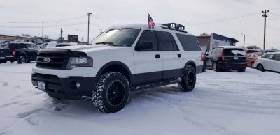

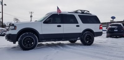

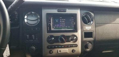

Here are a couple outside pics of the one I ended up purchasing. Someone else put quite a bit of money into it ie. Katzkin leather for all seats, kenwood touch screen gps audio unit, alpine DVD player for back seats, leveling kit and wheels tires etc. and less than 36k miles

Great looking rig!!
The SSV audio system but be completely different or the original completely rebuilt and rewired the system.
I have found zero way of integrating an aftermarket unit to the sync system. Without running it as a piggyback system.
I did’t realize the SSV used the older round foglights vs the newer LED bars.
