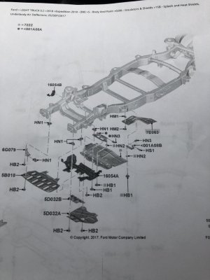

Swung by the dealer and he is having some difficulty locating that skid plate.
Everything he comes up with sends him a plate of some sort that is in the rear.
Apparently the 7E063 is Fords designation dealing with transfer case parts and accessories. I have been under my Expedition a few times and don’t recognize that plate so I’ll crawl under there when I get home from work.
He came up with the 2018 part with no issue.
I left without the full part number for the plate in the first illustration.
He is going to keep looking and let me know what he finds.
I am a bit curious as to what the differences are for the 18 plate.
I am guessing mounting holes but not sure.

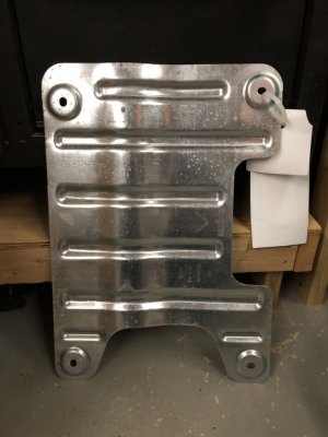

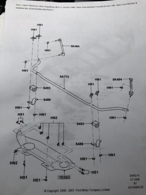

My unknown skid plate came in.
FL1Z-7E063-A
It looks nothing like the picture that was given to me and posted above given to me by the parts guy.
This is the only skid plate he can locate for the SSV aside from the fuel tank skids.
From the picture above this seems to be some sort of rear sway bar skid plate. It is pretty large and a whole lot more solid than I was expecting.
It cost me a whole $13
https://www.oemfordpart.com/oem-parts/ford-plate-fl1z7e063a
I have been under the truck a handful of times and don’t remember seeing this plate.
Hopefully weather stays decent and I can slide underneath tonight and see what I can find.
