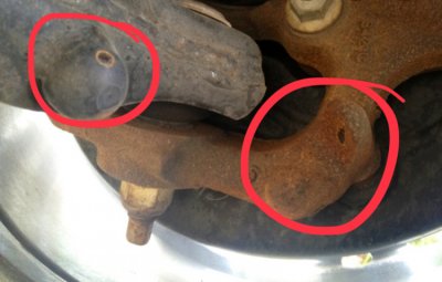

It’s not the EPAS. If it does it at full lock, get under the truck while your wife turns the steering wheel to full lock. Look behind the wheel for this little nub. It’s probably rubbing on the socket it fits into when your at full lock. It’s telling you your turning too far. This is probably the culprit. 2C6D9876-6E62-4433-9912-F8CC8B80E399.jpeg
