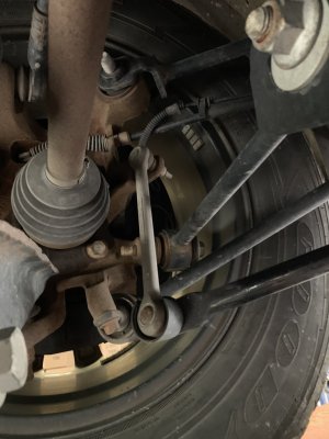

As much as I hate state inspections of vehicles especially a newer one, this one was actually beneficial. I also wanted to alert you to check yours.
My rear passenger side stabilizer bar failed. I have no idea how or why. I haven't even noticed any handling differences. Easy fix but the mechanic doing the inspection and I have never seen one fail especially in a newer vehicle.

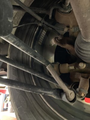

I'm just hoping it's an anomaly and not showing poor quality in the parts put into this vehicle. I don't take corners like a madman and haven't hit any potholes or bumps that would make me think something would break. We do have lots of traffic circles in this area. Again I take them like I'm driving a large high center of gravity SUV.broken passenger rear stablizer 2.JPG drivers side rear stablizer.JPG
The two pics are the rear broken bar and the driver's side intact one.

That has to be a casting flaw, those are solid parts and when they fail its at the joint that gets slop and causes clunking
I've never seen one break in half on any vehicle unless some road debris or rock hit it?
Other than a casting/material issue, it's the only thing I can think of yet I don't recall hearing or feeling anything that would break it.

Wow the top half of it is gone, did you pull that off or was it missing when inspected?
Missing.
Now if something hit it, shearing it off and taking the top part with it, how did it miss everything else next to it?
Aliens? Metal eating virus that died halfway down? Ran over a disintegration ray gun that only had one shot left? Gremlin?
Was this tied to the mysterious button in another thread?

I believe that you were possibly the target of a radio-controlled car bomb that misfired.....
I did check mine....all good, thanks
It sure looks and sounds to me like the top of yours wasn't fastened correctly, allowing it to rotate and fall downward against the adjoining bar.....bouncing along happy as can be until one day, one perfectly placed impact at a weak spot was all it took to cause the casting to crack and fall away......just my guess although not nearly as entertaining as the Alien possibility!

Let's go with the aliens! At least you discovered it before further damage and can get it fixed. Ford taking care of it for you?
Ford would. I'm at 53,000 miles so the bumper to bumper warranty is done. I do have the Ford protect extended warranty which is subject to $100 deductible. The repair is less than that. I let the mom & pop repair shop I use for inspections do it.

I find it amazing that the other end came off the mounting bolt. How in the hell does that happen? This has got to be a bad casting. I'm going to postulate that the end piece (with the bolt hole) snapped off, then the rod rotated down and either hit the road or the rim while moving and then broke it in half.
Another question for the group: why is that link a different color than the rest of the suspension parts?

Agree with the bad casting theory. I once bought an oil filter for one of my old Expys.....a standard PH-2 ...that came without the convenience of threads! I dicked with that thing for 10 minutes before I realized it<LMAO>!
Guess on the color due to a hardened finished cast iron vs the rough hewn of the wheel, etc.....?
