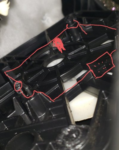

Clicking from front driver side, above your right knee. I found it was the driver blend door actuator. I bought a replacement and when it arrived, I found it wouldn't fit due to connector different and rounded body vice square body. I bought the correct one only to find out it did not fit. I compared old/new and exactly same. I tried putting the old one in and same thing (Huh? Yeah). Spent 2 days after work and no luck. The actuator has a locating slot, so only one way to mount. If I align mounting holes, the gear is above the hole mount gear in hole, mounting holes don't align?? Anyone have pic of what there's looks like? I slide my seat back and bend over backwards to work on it. 20241030_181451.jpg?hash=d38d7e4b0221e866870ba0ac3882f40a.jpg20241030_183102.jpg20241030_182421.jpg

Long overdue reply.... I will be replacing mine for the third time in a year tomorrow. I ran into the same issue the first time i changed one out. What I had to do was connect the power to the unit and turn the key on, that cause it to engage and start turning the gear drive. I had to do it a couple time to get the locating tooth gap to align close enough to get it started.

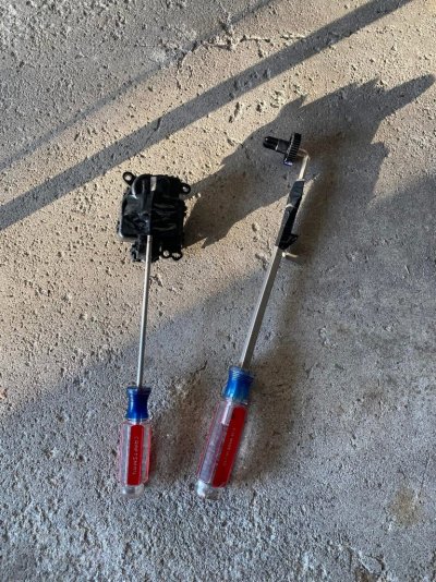

Not sure if it will work for the Expedition. For me tight space and gravity was no help this is what I did to hold it while putting bolts back in or to hold the wheel to get it up into the hole to get it lined up.
