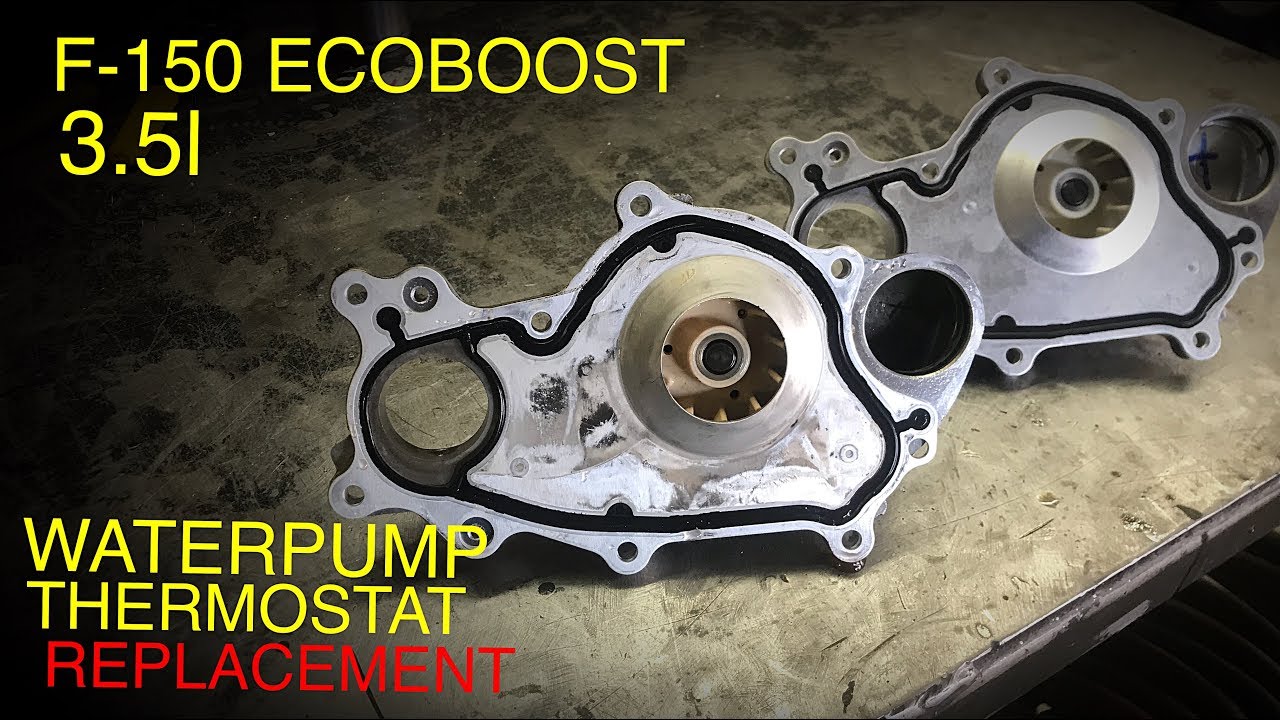

Hello all,
Does anyone know where I can find the location, on the motor, the water pump for:
2017 Ford Expedition 3.5 liter V6 ?
Diagram or the service manual?
Got quoted over $800.00 and change by Pep Boys!
P.S.
Anything else I should look at or replace while it's in pieces?
Thanks in advance.
