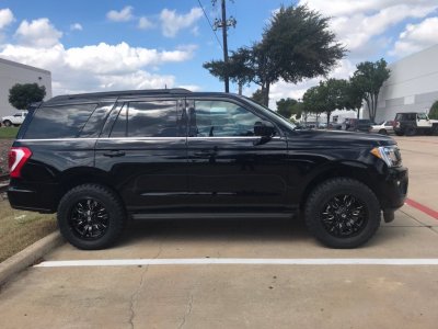

I have a 2018 XLT 4wd with the Ready Lift 3/2in and I'm running LT295/65R20 with 0 issues.... I think the 2wd will be just fine. I would think the 295/65/20 or 35's would be as big as you could go.
