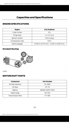

Welcome to the forum, one of the things to keep in mind, you are asking questions but you are not citing where (other than Ford), you are obtaining your information.
There are at times, the potential for errors, especially if a website "quotes" specs from another site.
The specs on the 2018 Expedition are the same as the F-150, unless my Factory service manual has a typographical error, pic attached...also, I had no idea brake pads would be warrantied at all, bonus.

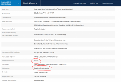

I should've been more clear where my sources are from. It is actually directly from Ford Website, under Expedition spec sheet. I circled the compression and Fuel delivery. I know sometimes these web masters just copy and paste the information, so that's why I decided to ask this questions to this forum.
Per manual that you have posted, it looks like Ford website has the incorrect information on compression.
I wouldn't think Ford would remove dual injection from Expedition, but still can't confirm this information.

Indeed, as yet another example...
If you look at the bottom of the page of service manual screenshot, you'd see it's the 2nd.
