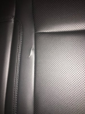

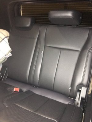

So I just purchased (meaning yesterday afternoon) a 2018 Expy Max XLT 4x4, uprading from a 2007 Expy EL Limited. I really like the style and features (miss my shifter/hand rest). Second day, inspecting everything and went to play with the third row recline button and I notice a 2" cut in the leather on the back rest, agghhh. Where they may have cut the leather while cutting off shipping plastic.

Yeah, I contacted the sales rep with pics. They had an exterior inspection sheet but no interior sign off and I just didn't notice it. I'm pretty sure the dealership will take care of it, or at least they better

They did for me. Same thing but on the driver seat. No incline shudder though.

That cut in the leather stinks. Someone in too much of a hurry and didn't care... I thought I noted a shudder the 1st day or two of driving and then discovered it was the Auto Stop-Start feature many don't like. It only occurs if you come to a complete stop. The engine shuts off and comes back on when you release the brake pedal. If I was quick and went immediately onto the gas I noticed what I would describe as a shudder. I've learned to let off the brake and allow that 1/2 second for the engine to come up before stepping on the throttle. I'm actually impressed with how transparent the shifts are. If it wasn't for the 1-10 on the dash, I really can't tell when it's shifting under light acceleration.

Follow up: Ford is going to replace the third row leather but it's going to take awhile for them to manufacture and send to dealership, but at least they are making it right.
