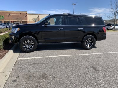

I have a ReadyLIFT 3/2 paired with 34” tires (Nitto Ridge Grapplers LT285/70 R18) and 18” wheels (Black Rhino Chamber) with a +12 offset.
I have no rubbing and no cutting to the stock components was needed. The only thing that needed trimmed was my WeatherTech mud flap.

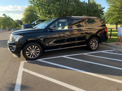

Not 18" wheels but I have the readylift kit with 20" wheels +18 offset 295/60/20 Cooper Discoverer at3 xlt and it rubbed ever so slightly on the front wheel well on turn so just moved it forward a inch and never had another issue.

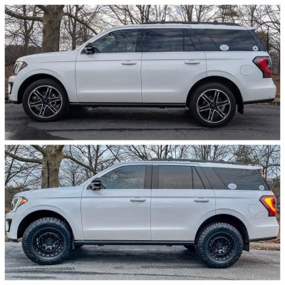

Currently, have 33x12.5R17's on Raptor wheels w/o any rubbing on road with stock suspension. Haven't tried it off-road yet.
