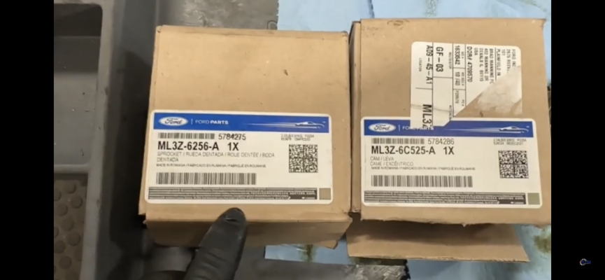

Picked up the truck yesterday, just under 2 weeks.
Cold start this morning, no CP rattle, so that's promising.
Invoice shows ML3Z-6256-A Sprocket - Cam 5560 and ML3Z-6C525-A Cam 556012 for part nos.
Going from the nimble Explorer to the Minibus Expy Max was an adjustment, but the wife's happy to have her truck back.
