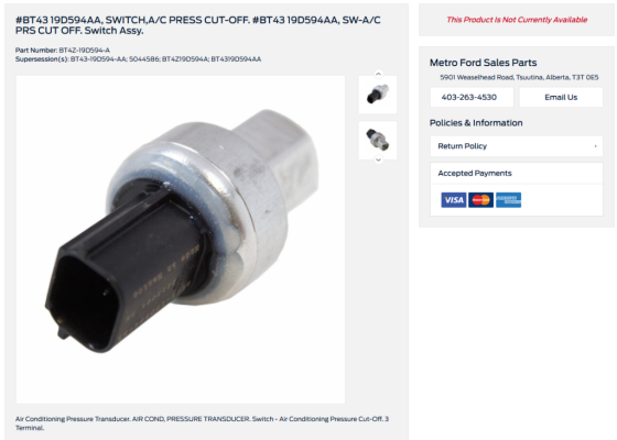

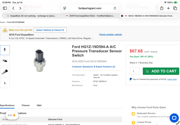

Also, Ford lists HG1Z19D594A as the part but is 'unavailable', finding an aftermarket sensor is harder than I'd expect!
HG1Z19D594A
HG1Z19D594A
