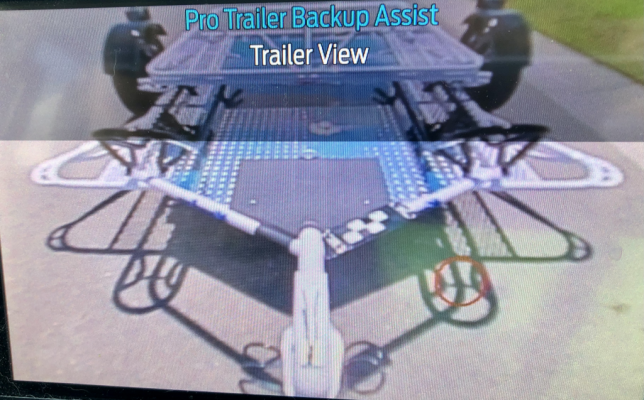

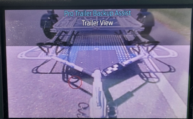

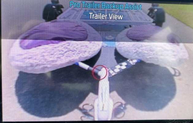

Our 2020 Max Platinum has the same and other issues.
- It will not find the label and gives an error.
- Now after the last attempt to using the pro back up system / label the dash board display when you shut off the car and restart the car returns back to the tow display.
I see the 2021 no longer uses the label and now has a module and cable you plug into the car and place the module on the trailer

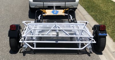

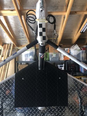

I don't know what trailer you are using, but I do know that some Airstream owners have had problems with the backup system. Apparently all the shiny aluminum of an Airstream confuses the camera as it tries to locate the sticker.
Brent Wahl
Jun 6, 2020
44
16
Space Coast Florida
I do have some Al reflection will look at
