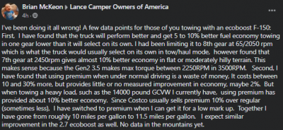

mwl001
Sep 8, 2020
190
83
Scottsdale AZ
Nope, it's the opposite. It drives the turbos harder when going up grades instead of downshifting. Even in tow/haul mode, my six speed will go up grades in 5th and 6th if you let it.
I did actually find this in a travel trailer forum I belong to - appears that locking gears out actually drives the turbos less... giving better mileage.

mwl001
Sep 8, 2020
190
83
Scottsdale AZ
I didn't notice any difference whatsoever PA to FL in all 10 gears vs FL to PA locked out at 8th. Guess I try again this summer to see what locked at 7th is like for a few tanks and see... Makes sense given max torque figures/worth a try!
Yeah, I doubt you would have. I watch the gear indicator all the time and I very rarely snuck into 9th or 10th gear unless we had a major tailwind, so under most conditions the programming pushes you into 8th gear at around 2100-2200 rpm and boost with turbo for all that wind resistance. We leave on a big trip in a couple of weeks so I'll have a lot of miles and a good comparison with last year's trip (same trailer) to compare.
