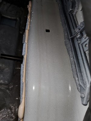

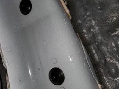

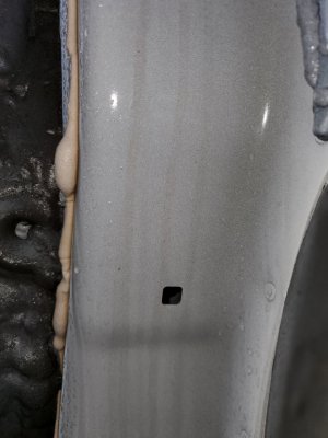

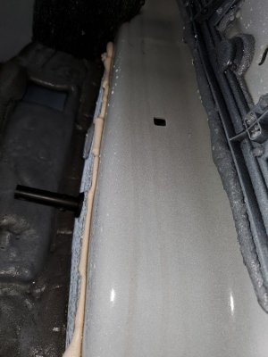

I have been working on alot of ford water leaks lately just wanted to post this so others can be informed. as some of us know there is a problem with the ac system leaking into the vehicle on 2018-20 Ford f150s and a few other models I just found a new one on a brand new 2020 expedition I assume the leak was the a A/C in the right front but seen the fix in the drain tube was already done I had water tested the truck and found that water was coming in the front piller took the fender liner loose and found that from the factory the body plugs were not installed on the lower piller keep an eye out for this as well when looking for leaking

OP, your post is a tad confusing, but is the gist of it, pull the passenger side fender liner closest to the passenger compartment, and look up inside on the chassis for these square holes? Are those special plugs with square posts or are the technically round and just crammed into square holes?

MSUICEMAN
Oct 29, 2015
SE Michigan
had the exact same issue on my 2020. dealer didn't believe it, tried to find the leak everywhere else, just to come to find the missing body plugs. waste of time and money. going to call ford and pitch a fit to try to get some of my diag money back, but at least take out a pound of flesh. nice quality and process control.
