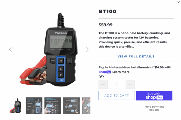

Before dropping $ on a new battery, have it tested! I have this Topdon BT100 and use it all the time. When I bought my used 2020 just over a year ago, my battery must have been sitting on the lot for quite a while and had a low enough voltage the computer would go into low power mode and AS/S never kicked in because of battery charging. The Topdon showed marginal capacity left. I started putting the battery on a trickle charger and gradually it regained full capacity. AS/S started working again out of the blue.

Topdon BT100 - I highly recommend this battery checker, too! I purchased $10 less expensive Topdon meter first but the results were inconsistent (checking by repeating testing, one time said Good, other times said Rplace), then returned the first one and got this one. I compared two side by side before returning the first one to Amazon, and BT100 readings were consistent, so I trust the meter. My Expedition was delivered Dec. 2018 as new, and I have never changed the battery. I fianally replaced the battery several weeks ago. When I brought the car to a local alignment service shop (due to questionalble work at a Ford dealership), since the brake lamp was on for an hour or so, the car did not start due to lower cranking power. The shop jumped started the car, running it for a while to make sure I could drive safely back home. I knew the symptoms of low battery charge, such as no response of door knob touch sensors lock / unlock (only driver's door works and other doors stop working), and auto start/stop does not work (I usually disable it by the switch, though). This time I did not see any bad signs, so I wondered what was going on. But when I got back home and checked the battery by the meter, it showed Repace. I hooked up my battery charger (CTEK MULTI US 7002), and charged it up over a night or two, and checking it by the meter before / after charge, and I did so for around a week. I found that the meter constanlty showed Replace (only once showed Good / Recharge), and it seemed the battery did not hold good charge (once it got 100% but easily got down to 30-40%, other times the charge level did not go full). The car was still running just fine, so the meter results seems deceiving but actually I did experience the car did not start at the alingment shop (first time ever on this car like that), so I trusted the meter. I used the battery for 5 years (38K miles), so it is about the time to replace it, anyway. Changed the battery at the dealership (I know they charge more than I hoped but I do not want to run into crazy electrical issues, may need reset functions, etc.), and my trusy meter of course shows Good Battery, I am happy now. I felt I was fortunate that the alignment shop incident happened to warn me the battery life is ending and therefore I did not run into the worse situation. and could decide to spend right money for a new battery.
