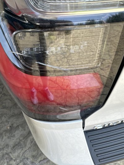

My 2018 left rear taillight has cracks. I do not think these are from any impact. I have Ford Extended Warranty with LED lighting option. Think the warranty might cover replacement?

Gonna have to convince them that the cracks are not from outside impacts/damage. Good that you have the lighting option on your ESP.
