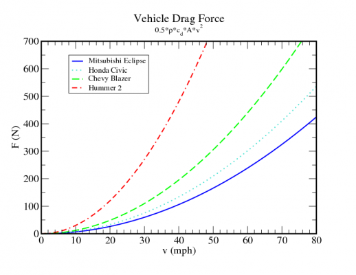

I have the readylift kit with LT285/60/R20 Open County MTs and 3.31s. Turned a big, heavy brick into a bigger, heavier brick. I don't recommend it, and I will go down to a 275/60 non E tire when the time comes if I don't trade first.
With my setup on 93 octane, 10th gear is completely worthless so I lock it out, and it's in boost over 70 most of the time in 9th gear unless the road is very flat. Around town I like to drive in tow/haul mode otherwise the shift points are too low.
I will disagree with LCG on octane; anecdotally 87 octane makes me start going into boost just maintaining 60mph in 9th. I agree though with regards to the higher speeds, and it's even more pronounced with the lift and running larger tires.
After 30k miles, I'm averaging 16mpg with mostly rural 2 lane roads. By comparison, my leveled '21 F150, 3.5EB, 4x4 3.55s LT275/65/R20s is averaging 19.4 after 37k miles. F150 weighs around 800lbs less IIRC.
Grabbed the below values off a texas tech page, and assuming the values are correct this chart gives an idea of speed vs drag.
