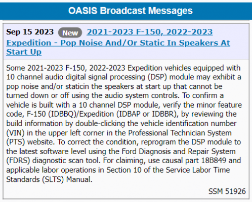

I had two audio issues. I had the loud pop and then no audio. And I had the screeching noise that wouldn’t turn off. I made and appointment and they did the radio flash update but they said that only works about 50% of the time. If that doesn’t work they have to replace something with the amplifier. That was back in July and I haven’t had any issues since, and it was only those two times.

While we're waiting for feedback from @haviland on your question, I'll offer a few things...
SSM 51926's DSP software update recommendation applied to Expeditions equipped with the B&O 12-speaker sound system (IDBAP) and the B&O 22-speaker sound system (IDBBR).
In response to your post, I checked the communications archive and SSM 51926 no longer shows up, and I do not recall any subsequent communication about the described symptoms.
With that said, I checked DSP software-level status on two random Expeditions equipped with B&O sound systems.
A 2022 Expedition Limited with the 12-speaker system had not been updated since November 2022 and Ford's Professional Technician System (PTS) shows a DSP update is now available.
A 2022 Expedition Platinum with the 22-speaker system had been updated on March 17, 2025, and PTS also shows that a DSP update is now available.
In both cases, the prior DSP software updates appear to have occurred Over-The-Air (OTA), since no record exists of the vehicles having been worked on by a dealership technician during those timeframes.
Good luck!
