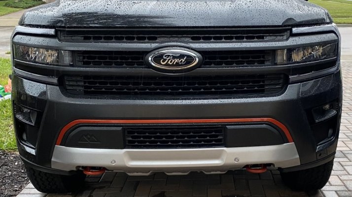

I saw that post as well. Problem is the front end is much different now. I’m not sure where to put one, so as not to block the airflow to the engine, or block any of the driver assistance sensors.

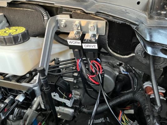

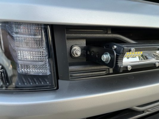

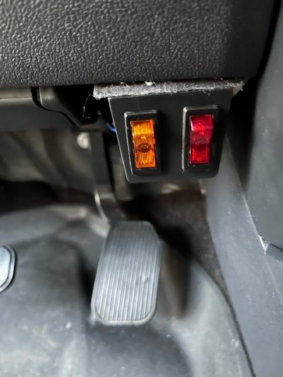

bought lights on ebay for about 15.00 each . got a light relay switch wiring kit at menards for about 25.00. I made some small angle bracket to mount them to the plastic grille. I will take some pictures tomorrow.
MTB2022
May 8, 2022
30
25
livonia Michigan
angle brackets home made with stainless fasteners. Switch set from Oreilly's, relay mount home made. power wire runs across the top of firewall to power center positive and negative power studs. wiring from relay runs between air box and apron and out through existing hole to the grille area in front of shutters.

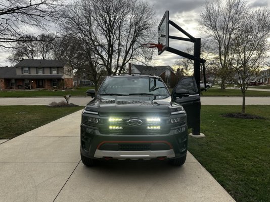

I just got 4 11 inch lights bars from M&R Automotive. These lights bars function as DRL amber but can change to white fog lights. Easy to install with the wiring harness that they offer. I highly recommend this option as I was searching for months to find something that functioned and looked great.

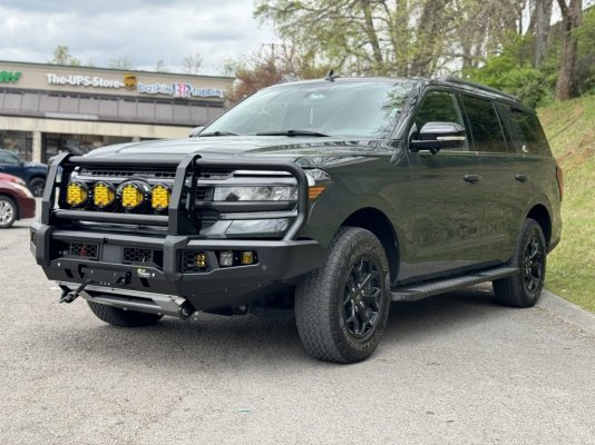

A little more than just a light bar! I’ve also seen a f150 / Raptor in grille setup that pulls two air baffles out and replaces them with Baja design lights
