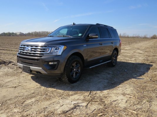

This is precisely what I am trying to accomplish. Not increase tow ability. Just add to the trucks stability while within the proper load and tow ranges. Increased off road performance would be nice also. I will accept a change in ride comfort.
I had no plans to level or lift my FX4 so I went with a 275x70x18 which is an inch taller than the stock tires but the same width. I lost about 1 mpg on the highway at posted speed limits. Braking is not bad even with about a 7 lb increase in weight per tire. Speedometer is off only 1 mph less according to a GPS. Close enough for me! Running at 42 psi cold will give you a ride not much rougher than stock tires. Put about 6K miles on the BFG's and pleased with them so far. Had the old TA/KO's in the past and really liked them so I went with the new version.
