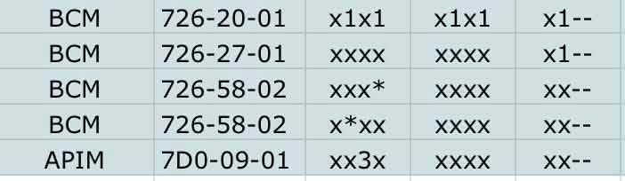

Could someone kindly provide the Original values across all these rows for BCM and APIM? I would greatly appreciate the help.

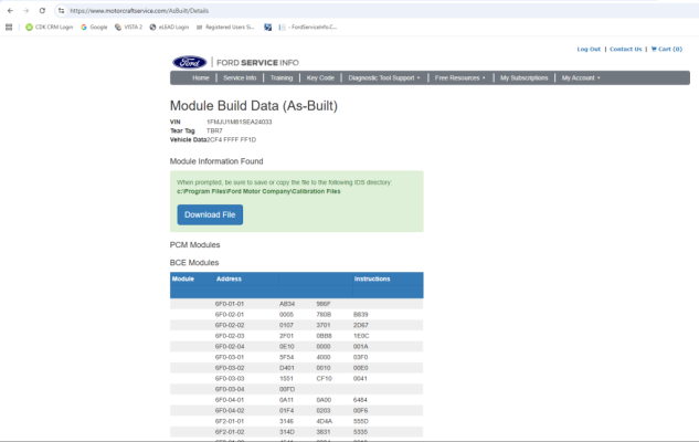

If you need the ab file for your vehicle, you can get them here with your VIN:
Assuming you just made the changes and your truck has not synced up with the cloud yet, this will contain the values your truck had before you changed anything. If the changes you made synced with the server, you will need to type in the VIN of another vehicle like yours in terms of the year, trim level etc.

The file you pull from there is an as-built file that contains all the bits of config in every module. All you need to do is change the extension from ab to txt so you can open it and read it. Then you control F for what you're looking for. In the case of 720-20-01, it would look like this if you convert the file from ab to text:
So the ab value would be 0000 4E.
With the VIN, I can look it up in PTS and it presents it nicely like this:
Edit: This is from a Mach E and not an Expo, but same logic applies.

My Vehicle has been untouched. Here are my codes:
726-20-0100000000004E
726-27-0100011401006B
726-58-02000000000188
7D0-09-016313AA29FE28
And in case you made a typo:
726-59-02 0100 0000 0089

In case anyone finds it useful, link below is for a web-based tool that you can use to open ab files and easily see values. You can also load two ab files and compare values side-by-side. It's been a life-saver for me.

Exactly, I can read it fine without changing the .ab extension to .txt. I was trying to explain that right now nothing works correctly for GEN5 Expedition's new Ford Digital Experience.

On another note, the motorcraft site now shows you the config in plain english. No need to download the file and open it anymore. Not sure when they added that, but that's handy. I used the VIN from a random 2025 Expo online for sale. If anyone wants to experiement, you can just grab the ab file from here and you'll have a reference point of what you need to revery back to if you mess something up. However, without a spreadsheet, you'd be working blindly.
