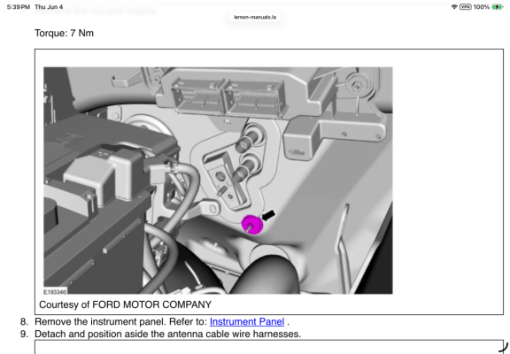

I would look at the cabin air filter. The case drain should be below where the heater hoses and air conditioning lines connect. You may need to loosen or remove the passenger front inner fender. The drain should be below the nut colored in this drawing purple. This is behind the battery and shows the PCM disconnected.

@AWAR , thank you! I'm able to see the area that the picture is showing, but you are right, I will have to remove the fender in order to access it. Will take it to the dealership as I'm not sure if any intervention with a screwdriver will affect the warranty.
