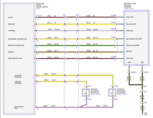

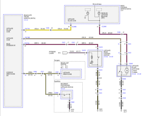

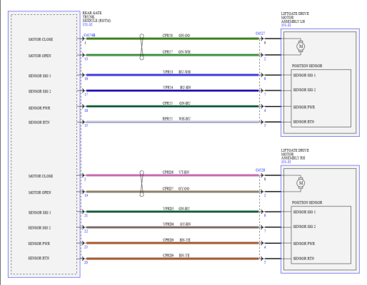

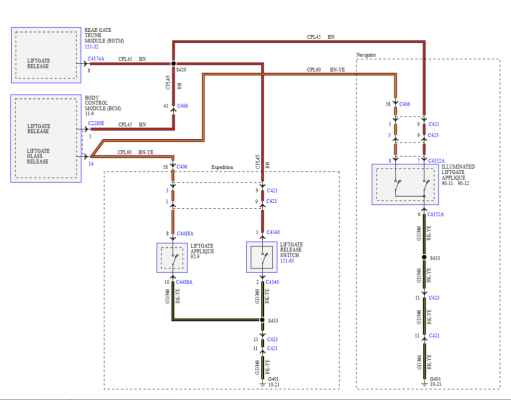

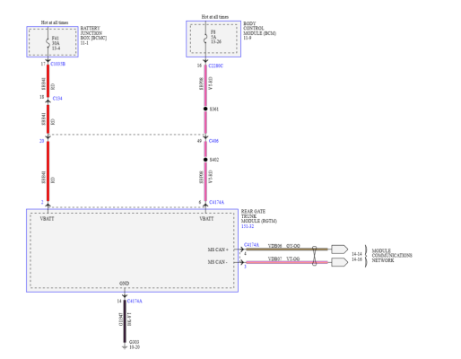

Also, did some research for you on the wiring schematics... note available using my resource at this particular time. A little too new for my go to place. I've got access to every make, and model. Even some overseas stuff. Also have tractor, and small engine info as well. Unfortunately, none of that helps you.
All that said, the newest found was 2023. Take a look, and compare to see if the wiring, colors, and components are compatible. Good luck.
