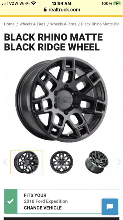

I am looking at Black Rhinos with a 12 offset. Therefore, they will be very similar to yours.

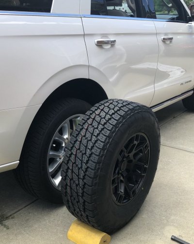

You are running tires a wee bit thinner, but taller. And you said no rubbing? Even at full lock? I am sometimes at full lock backing into a campsite.
+12’s are a little to much if you run a taller and wider tire. +18’s seem to be the sweet spot.
The tires I am considering are either taller and same width or taller and narrower.
6mm is about a 1/4 inch difference.

I hope it happens. They look so much better with a bigger tire. But I will say the pics above on a +12 will be rubbing. I’d dump my +12’s if I could find a wheel I like in a +18.
