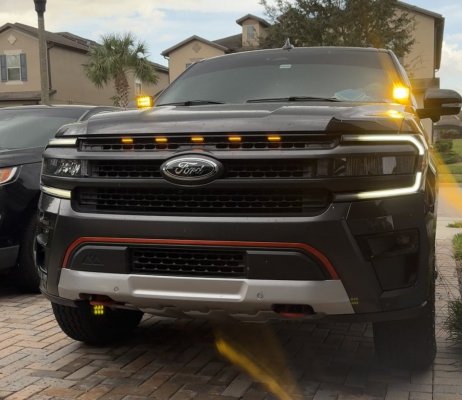

I'm trying to install some Raptor style grill lights, and I need to wire them into the Daytime Running Lights. Does anyone have a wiring diagram for the headlight assembly? Thanks in advance. Wire color photo is attached!

The website is F150leds.com. The link is as follows.
You can purchase them in 3, 4, or 5. I ended up cutting the connectors off, drilling through the grill, running the wiring through, and splicing the connectors back on.
Turned out better than I expected!

Thx for that! Can you get another pic or few out in the open with the DRLs all on?
