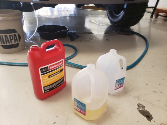

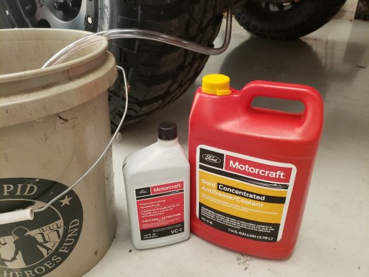

To do this you will need 2-3 gallons of the Ford Gold antifreeze/coolant (VC-7-B), a quart of Motorcraft VC-1 coolant flush fluid, the same surgical tubing as before, a bucket or two, containers for disposal, ready access to a hose, and some distilled water (optional, but only a few dollars worth is needed).

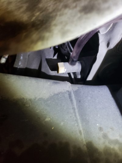

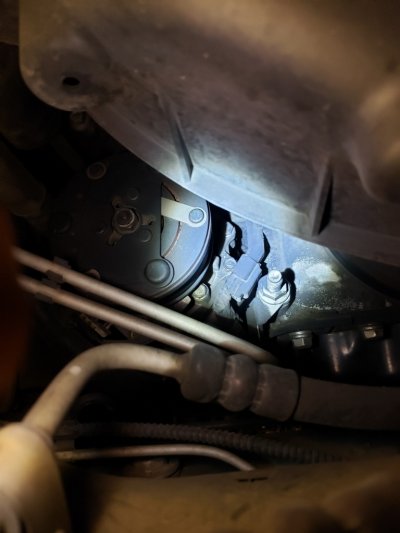

Once you have everything ready, the first thing I did was a pre-flush. Remove the cap to the coolant reservoir, and locate the drain plug to the radiator. It will be on the bottom corner of the radiator on the passenger side, and the only way to access it is from underneath. There should be a nozzle that will perfectly fit the same diameter tubing I used in the power steering flush above. From the underside it should look like this:
That little white hex shape is the release. Attach the tubing then turn gently, if you apply a lot of force you can round off the "bolt" as it is made out of plastic. During the pre-flush it helps if the engine is cool. If you are doing this with a warm engine be very careful as it will be very hot.

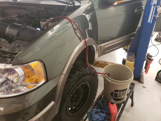

Now open the drain plug and let all of the coolant drain. It should take about 5-10 min. While it is draining flush it out with a hose spraying into the coolant reservoir, making sure no large amounts of air get into the coolant system. If you use the jet setting on your hose you can knock loose any of the built up gunk in the reservoir. Keep flushing until the fluid coming out of the hose runs clear. Then stop filling with the hose, drain the reservoir almost to the bottom, and close the drain plug. Keep the tubing attached. Add your VC-1 fluid to the reservoir, and fill the rest of the way with water.

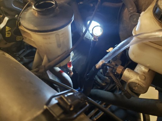

Now comes the slightly more tricky part, a friend would come in handy here but you can do it yourself as I did. Shut off the engine and let it cool for about 5 minutes, just enough that you can SLOWLY open the cap to the coolant reservoir without it blowing up in your face. Be very careful when doing this as it will be under pressure. Make sure your tubing is still attached to the drain plug, and open it up. Have a friend add water from the hose slowly, or figure out a way to keep the hose on and in one spot so no air gets in the system. Start up the engine again while constantly adding and draining water from the system. Do this for a few minutes with the engine idling to completely flush out the VC-1 fluid.

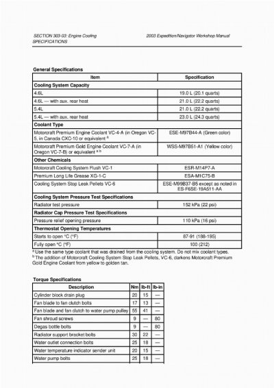

The system has a ~6 gallon capacity, so I used about 2.5 gallons of the concentrated coolant and 3 gallons of distilled water. The first gallon of coolant I added directly into the reservoir without premixing with the engine still running. Then keep adding a mix of 50/50 coolant/distilled water, and monitor the tubing and close the drain screw once you see the coolant you just added start to drain.
