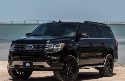

Height wise, 34” might just barely clear without any rubbing or trimming. If you stay below 11.50” wide, you should be fine. However, that size tire may require a lift kit like Readylift 3/2.
My opinion, if you want a larger tire I would put a Readylift 3/2 kit on it and 33/12.50/20s. Younwill still get factory feel for handling and it will definitely make your Ex stand out from others. Not sure what color you have but black looks best to me
This is with the 3/2 lift and 35/12.50/20 WHICH WILL REQUIRE A MORE NEGATIVE OFFSET WHEEL AND TRIMMING

Lol. I’m a 2016 owner, just wanted to show you a pic I found of a 2018.
This is mine
Yes, the taller and wider the tire the less clearance you have when the suspension is fully compressed or sagging. I don’t do any crazy off-road stuff so I’ve never had that issue. Regular bumps in the road or parking lots won’t cause contact unless you plow over them hauling ass.
