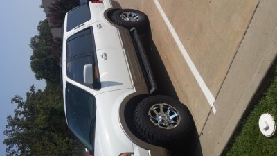

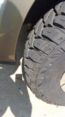

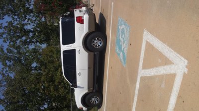

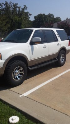

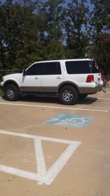

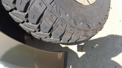

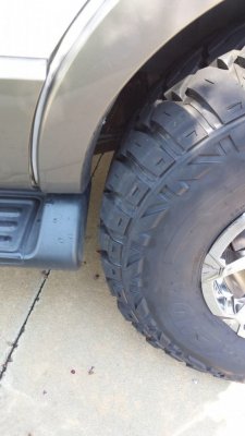

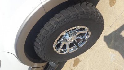

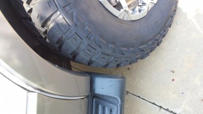

Got 17x9 35s to fit with a 3/2 lift with step rails no trimming except a little on the front bumper black plastic. no rubbing. What do you guys think?

Looks good. What's the clearance and articulation with the 35s on? I have heard that 35s really dont let you articulate well on rough terrain and I can't decide between 33s or 35s yet so that would be a deciding factor for me.

i haven't had any problems yet. i have a ton of room to flex with the +20 offset
