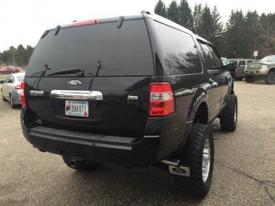

Finally tracked this one down!!! It was a lot harder than I though but I got my answers. 3" performance accessories body lift done on it from a 2009 F150 crew cab. Well got the Ready lift and ordering the body lift tonight gentleman. This raptor Expy is coming closer and closer CBI Offroad can make a front and rear custom bumper also. Check out these bumpers for the 3rd gen.

Don't expect to get readylifts warranty then. They won't honor it when you couple it with other suspension parts or body lifts

I find my 3 inch front lift kinda obnoxious... probably gonna ditch the spacers the next time the front wheels need to come off

Did someone say warranty void.... LOL I think by now you know that I don't give two flying "EFFS" about warranty!!! All my trucks have voided their warranty within 2-3 months... I'm in the process of seeing if I can go with a 6" 09 lift up front from an 09 F150 with a rear end and leafs from an 09 F150 also... will be even better! 9" total lift. I'm tired of us 07 up guys having zero options on lifts!! I want to do a rear axle swap from an 09 F150 and a 6" lift up front just to prove it can be done. Money yeah... maybe but I can source a good rear end from an 09. Its not an overnight project for me by no means but I am going to do something soon enough!! Slow and steady wins the race like we say here in the Navy.

View attachment 20473what rear bumper brackets did u do n how was the steering shaft n pedals I got a 08 kr I want the 3 body lift on but scared cuz of the steering shaft n electric pedals

Did you get a custom upper control arm? I did the 1.5” rancho coil overs with 2” spacers and my upper was hitting the springs.
