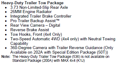

Do you have the window sticker, if so, you should see a line like this under Optional Equipment:
If you don't see that on your window sticker, you don't have the package.
Heavy-Duty Trailer Tow Package includes the following on XLTs. Other trim lines may be slightly different:
