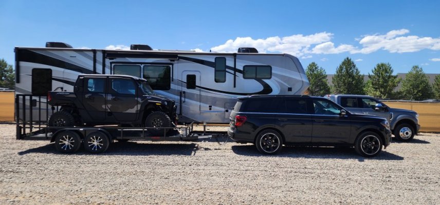

I ended up with the flat utility trailer and I love it. The Xpedition XP5 is super easy to tie down and you barely know the trailer is back there. Love it! The picture is from the day we picked up the XP5 and trailer.

WOW!! JG. That's just a beautiful and classy looking open trailer. You should be proud to be towing that behind your sharp Expy. Never had any trailer with an open-mesh tilt-up ramp but it makes sense to be open-mesh to reduce air drag. Does this new trailer have 4-wheel brakes? I also like your trailer wheels! Good job there and congratulations! Lance
Thanks!
This is a heavily modified Echo trailer. The base model is the EA-16-15T-MD Echo Advantage — a 16' tandem axle trailer with 15" wheels and a metal deck.
The main reason for choosing this trailer and making the modifications was to ensure compatibility with a Weight Distribution (WD) hitch. With our Expedition, any trailer over 6,000 lbs requires a WD hitch, so most of the upgrades focused on supporting that.
All modifications were performed by Echo, including:
  • Aluminum wheels
  • 4" frame tube on the front A-frame/tongue (standard is 3") for added strength to handle the WD hitch
  • RAM 7,000# coupler (stock coupler is rated for 6,000# — this upgrade increased the GVWR to 7,000 lbs)
  • Spring-assisted ramp
  • Reinforced ramp
  • Front and rear axle brakes
  • Emergency brake tucked under the deck (required to provide 32" of unobstructed frame for the WD hitch)
  • Center post jack (replaces the stock folding jack mounted on the outside of the A-frame — again, for the needed 32")
Note: WD hitches put significant torque on the trailer tongue. I originally considered an aluminum trailer, but the manufacturer advised against it — the aluminum tongue can’t handle the torque from a WD hitch.
I didn’t choose the exact components. I simply gave Echo the performance specs I needed (like the 7,000 lb GVWR), and they selected the right parts to make it happen — for example, adding the 7K RAM coupler.
Overall, I thought the price was very reasonable given all the upgrades.
Needless to say, with all that they did and for the price that they did it, I am an Echo Super Fan.

Yep, JG. It looks like you did your research and, with Echo's performance spec assistance, you ended up with a real nice and super sturdy trailer that you can depend on. I am also glad to see they included 4 wheel trailer brakes and the 4" tube HD tongue. Both of those are important and maybe someday will save you from an accident, which none of us needs nor wants. I also like to see the spring assisted and reinforced ramp. I am sure that it makes it so much easier to fold down and back up. Good job all around, on your part!
If you don't mind me asking, I have a couple of questions? Are those great looking aluminum wheels 15" dia? Is the ball hitch a 2-5/16" ball? Is the hitch (coupler) itself welded to the trailer tongue or is it bolted on? Our 7000#, 3 horse 2-5/16" hitch is bolted on and on my 7000# construction, box trailer, the 2-5/16" hitch is welded on w/ an adjustable height coupler double-Grade 8 bolted to a multi-hole, HD, vertical channel. Last, do you mind me asking how much your trailer cost, out the door from Echo? (not necessary & not being nosey, just curious with the higher costs of everything these days). Thanks, Lance

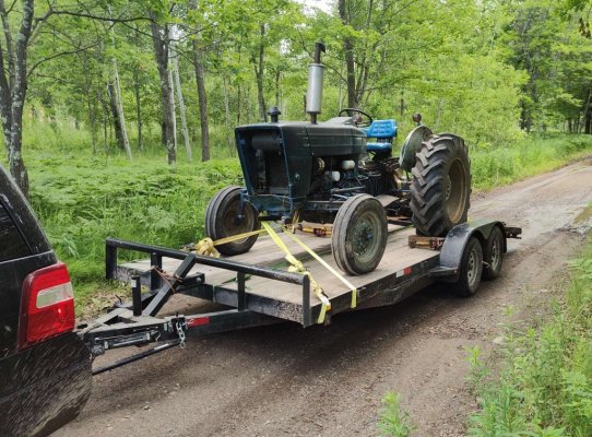

Funny this thread should pop up again. I just used my handy open trailer again this weekend to pick up another project!

Yep mr_dave. That's a very sturdy looking trailer, as well. Very cool looking tractor. Is it a grading tractor (can't see the back) or just a universal tractor? What year and brand is that? It appears to have some fairly nice tires on it and isn't too rusty nor filthy. Should be a fun project, Lance.
It's a 1979 Ford 3600 48hp 3cyl 8sp diesel, general Ag tractor. Made in Highland Park, MI. It's pretty dirty but it was taken care of and runs surprisingly well. I don't really have any use for it so the plan is to clean it up, replace a few parts, and sell it to a new home. If I had any excuses to keep it I would, it's a neat old machine.

That's very cool! Thanks for the speedy reply and info on the tractor. And, yes, it does sound like a "neat old machine". Lance
