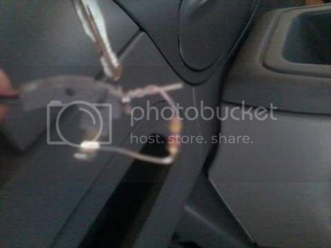

Well I just got home and thought I'd give it a shot. Turned key over, no theft light. Looked down and saw that thing that I pulled out of the ignition column still hanging. Although I did notice he had tied a resistor into it so it seems like he knows a bit about electrical stuff. He said he bypasses theft stuff all the time so I have to take his word for it. However battery was only showing 50% again so I'm charging it up again. Seems like I've read this before about the battery draining and anti-theft light blinking. May read up again....got tired of reading about it for a while.

Sure it was a resistor and not a diode? Just for curiousity
sent from my mind via telepathy
not really but I think it's a resistor. I'll go take a pic when I go back out this evening after battery is charged. I gotta form up a 25x25 basketball court concrete pad right now.
Notmyidi
Jul 28, 2012
107
oklahoma
According to the color band 3700 ohms to
Which would mean 12.6 would drop to 6.3

That module probably needed to see a certain voltage, internally it probably has a similar resistor, so adding it insures it will see it, or rather a voltage range
And 12.6 is a fully charged battery or max output of your battery
I could theorize for days but I've never dealt with Ford's theft interlock
