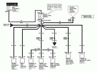

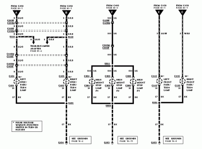

Help please in need of wiring diagram for the multifunction switch on a 97 Expedition Eddie B. and the signal flasher circut.
My issue is even with a new switch blinkers and flashers do not work. I have checked all the fuses and connectors. Now when i touch one of the wires that goes to the turn signal it makes the flasher work but no lights on dash or outside. Original problem was left turn signal and brake light in the rear wasn't working. Found loose wires at the connection on the multifunction switch. Tried to repair but broke a terminal that went into the switch.But before the terminal broke they all worked after nothing seems to work. First thought was fuse. But i replaced them.
Thank You again Gary.

Prints attached
