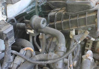

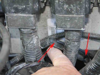

Here is what I found - First I found a vacuum hose that had come off - Easy fix.
But while I was looking at all the vacuum hoses I found what seems to be a hard plastic vacuum hose that was not plugged into anything. Does anyone know what it is for and why it is not terminated to anything?
The arrow over my finger is the open end. The arrow to the right is where both vacuum lines come out from a harness wrap. See pic.
Thanks for the reply's.

Talk about a coincidence, ive been trying to find out if that plugs into anything since my A/C front and rear stop working. Driving me nuts not knowing if it plugs into anything
