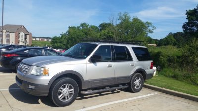

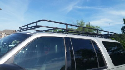

On a different note I thought I'd share this in case anyone is interested since I couldn't really found anyone who had done a roof rack like I wanted. So check out the pics and let me know what you think.
