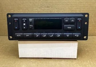

Long ago I had an 04 EB with automatic climate control and it would start to make a hissing-like sound with reduced and warm airflow after running for a while. I had to shut it down and wait, restart and it would work correctly. Did that when new. Never did figure it out. I suspected a vacuum control issue but that’s speculation. Of course you will want to put gauges on the high and low side but have to have air flowing across the evaporator to get accurate readings, and that may be a problem based on what you’re seeing and hearing. Also, look for wet, oily deposits near all ac connections along the passenger engine bay, and see if you can see the compressor from the bottom for a visual inspection.
