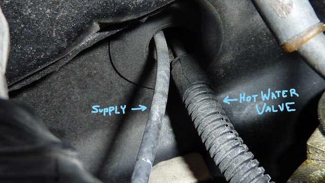

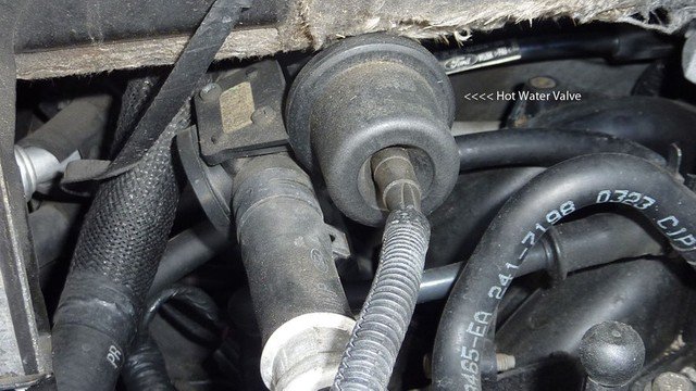

Inspect the supply side vacuum line for any cracks or obvious leaks. You might even hear it whistling with a leak. Inspect all of the vacuum lines there in behind the battery area as well. Make sure the vacuum line is properly plugged into the hot water valve as well.
HVAC vacuum supply line going into the firewall grommet ....
Vacuum line attached to hot water valve .....
