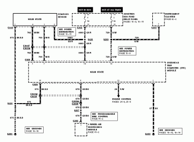

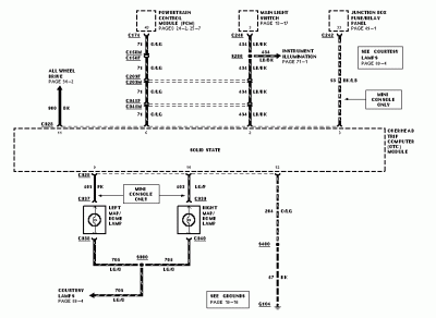

It may not be possible. Depends on if the wiring is already available. The PCM may need to be programed And temp may not be available.
Do you have the mini overhead console?
Have attached the wiring diagrams and also the connector pin layout Check to see if any of this is currently installed 102-01.gif 102-02.gif C928.gif
