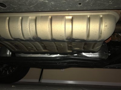

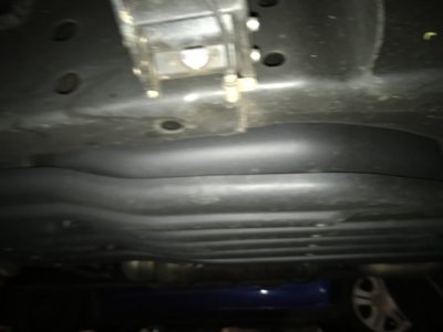

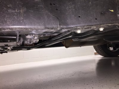

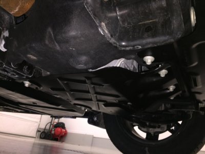

Here are a few more pics from underneath. The first pic is the muffler. The second is the gas tank and it does have a plate but it does appear to be plastic. The 3rd is from the spare looking forward, sorry for the crappy lighting.

Thanks for the photos. I forgot that the Navigator has two exhaust outlets on the passenger's side, which would explain the different muffler design. Fun to see the similarities/differences of Ford's implementation of the different Expedition trim levels and models (Expedition vs Navigator).

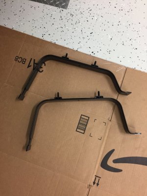

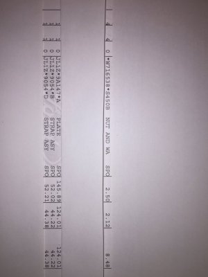

Installed the fuel tank skid plate today. You have to support the fuel tank with a floor jack and piece of lumber as you remove and replace the fuel tank straps. The new fuel tank straps have studs welded on them that allow the skid plate to be fastened with nuts. Relatively smooth installation, but I did have one of the speed nuts break as I was removing the first strap, so the nut was spinning feeling inside the frame crossmember. Fortunately I was able to get vise grips inside the end of the cross member to grab the nub and finish the job. I had an extra speed nut on hand to replace the broken one. I also included a photo of the part numbers and pricing for the straps, nuts, and plastic skid plate. It's roughly $200 worth of parts and you reuse the bolts that hold the fuel tank straps to the frame.

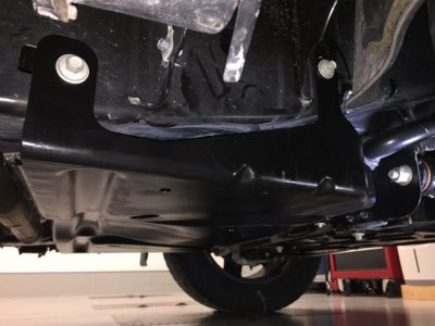

Finally had a chance to install the Raptor transmission skid plate today. The plate mounts to 4 places on the frame and the front edge attaches to an existing bracket. One nice thing is that it even has a removable panel to access the oil drain plug so you don't have to remove the skid plate for oil changes! Unfortunately the little access plate was on backorder, so I'll be picking it up in a couple weeks, but one of the photos below shows the cutout and view of the oil drain plug. Overall, this is what the Expedition should have as standard. It's much more robust than the standard plastic shield. Prices for the skid plate and hardware are shown and are roughly $200.

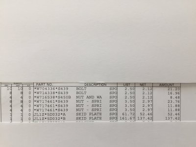

I also installed the front two skid plates that come standard on the FX4. As expected, no surprises since it's an OEM fitment. Photos and a parts list are attached. Roughly $250 in parts, brackets, and fasteners. I also painted everything with "Chassis Black" POR15 to help with corrosion in the salty winters.
