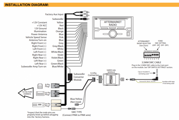

Not sure I can offer any help. Maybe the dip switch settings were incorrect. I bought everything from Crutchfield when I swapped my headunit. I used the Crux SWRFD-60L and had no issues. The headunit powered up and the factory sub and amp worked as expected, actually worked far better than with the factory headunit. I have to say my experience with Crutchfield over the last 30yrs has been outstanding. They will spend as much time troubleshooting with you as it takes.
Here's a screenshot of the wiring diagram and dip switch settings for my 2004 EB.
