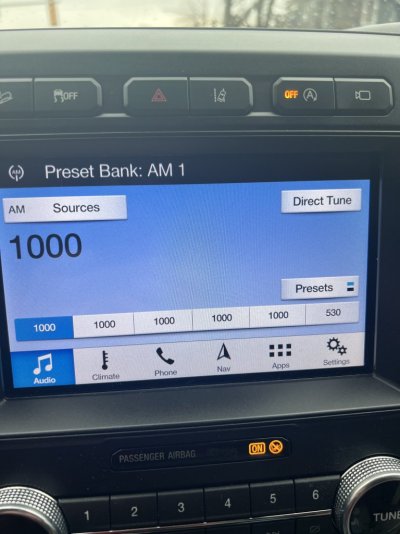

Anybody else have this happening. Just the the AM 1 preset bank. Is your last station 530? I preset then all to 1000. Turn the car off and back on and the last station goes to 530. The longer it sits without starting my first 2 change to like 1100 and 1300. 2019 Limited

Do you listen to AM? Also, graphics look a little off, what version of Sync is installed. Go in to settings and post the specific version. X.X.XXXXX will be the format.

I just want to know if anybody else has this problem. I am deep into Ford engineering trying to fix this. Am I the only one or do others have this also. Just look at your AM 1 preset band and tell me if you have what I have. Simple

It was not a crappy response. I have been to the dealer working with Ford Engineers no less than 9 times. Parts, modules, software updates, reinstalls. I'll assume you don't have my problem. Thank You.

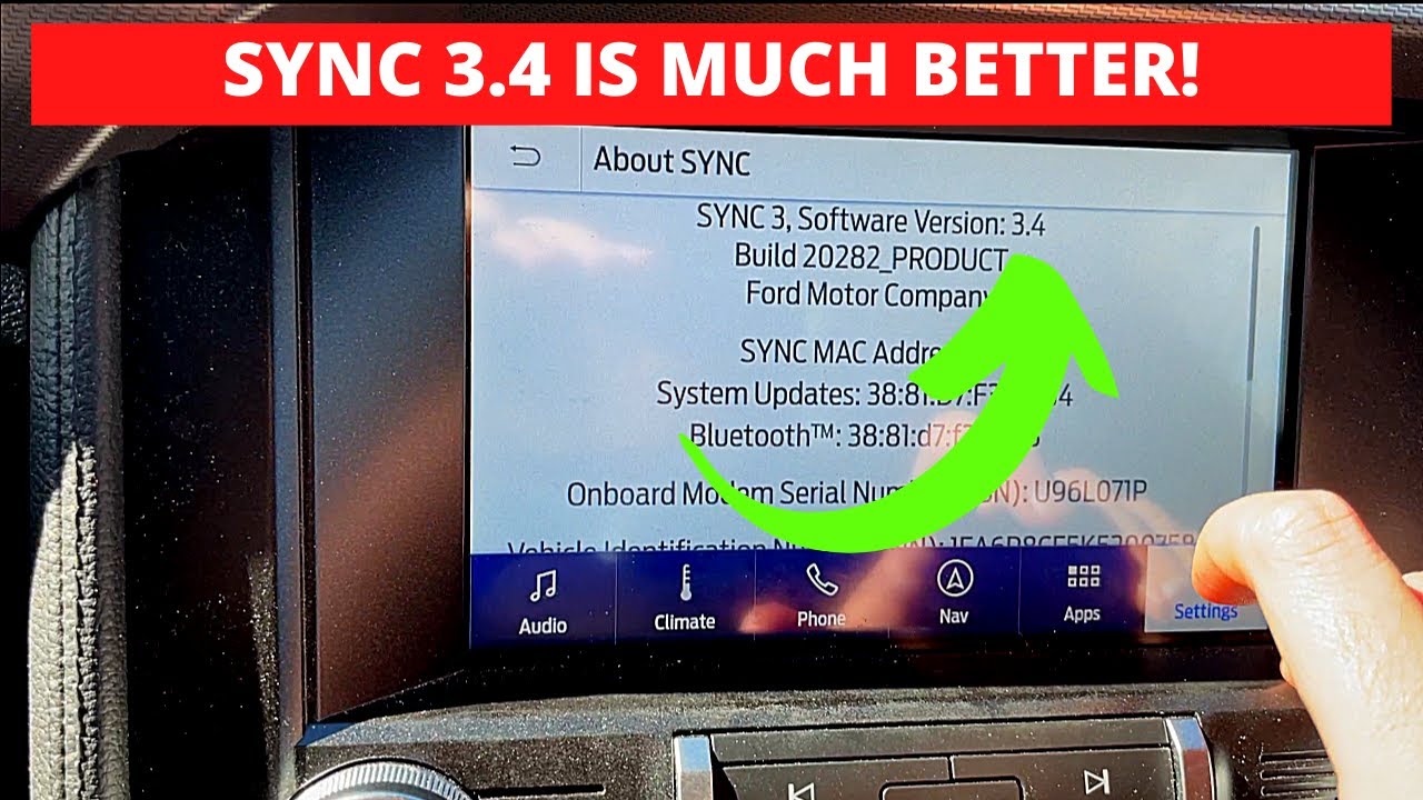

Just humor me and post your Sync version....I will bet it is NOWHERE near the current version. Maybe current based on what FRDS is telling the tech, but not current. If the APIM has already been swapped, that is the only hardware that would affect this issue. Dude, I am trying to help. Do you want a possible solution, or keep screwing with Ford? Completely up to you. I am not a rookie at this, and not taking a stab in the dark.
LokiWolf
Super Moderator
Super Moderator
Apr 2, 2016
3,653
2,460
Richmond VA
SYNC 3.0 20204
Yep, NOWHERE near the current version. I would be willing to bet $20 bucks that updating to 3.4.20282(Current available is 3.4.22020) or above will remedy the issue. My guess is that at some point your APIM was swapped, it has newer firmware, and they are based on your post putting an older version of Sync on it. It can cause all kinds of undocumented weird behavior. Since I have never heard of this issue, and based on your response, neither has the helpline, it is a weird combo. I would update the software, then bill the dealer for my time if I was you...but I'm not.
