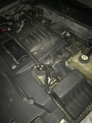

My 07 EB with the 3:31 rear end has just under 114,000 on the original plugs, took a trip from the north woods of Wisconsin,Boulder Junction, down to the Chicago area and got 21.5 mpg,around here mixed town and back roads going to Minocqua with temps below 0 most of the winter it's sitting right on 19.5 mpg,i will say it does not like town / urban driving with stop lights every couple of block's and the mpg falls fast IF i'm stuck for any length of time in that crap, still starts at the click of the key every time and runs like a sewing machine, LOVE OUR EXPY 5.4 with the 6 speed, if Ford still offered that engine & trans I might think about trading, I believe KISS, in Keep It Simple Stupid and do not want anything twin turbo with all the parts to go bad in a 10 speed.
